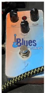

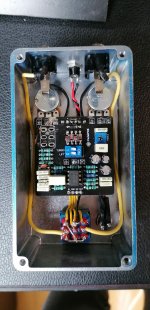

Built 2x Pedalpcb Pauper aka Analogman Prince of Tone clones. Great sounding overdrive pedals. Had solder problems with the relic one and left out the 3 way toggle switch. The royal one is actually my favourite drive pedal.
@Manuel Ammon Astounding and beautiful work as always. Very interesting relic job!
What diodes did you end up using? They look like 1N4148's?

I like my Pauper a lot, but wind up using my KOT more. I settled on using BA282's in my Pauper build which sounds different than MA858's to me. I also have a bunch of BAS33 diodes which to me sound more like the MA858/856. I used those in another KOT clone build. You might also like the King's Hand PCB (It's the MBB side of the Duellist). To me the pedal sounds like a "girthier" version of the POT. Very cool pedal as well.

Thanks for the information. Helps slot to understand the circuit of a Kot....
