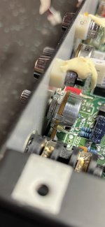

Sadly the gain pot swap didn’t revive this little vox. (Night train 15)
Buddy dropped it off and said it had an input jack problem - losing signal, but wiggling the cable would bring it back.
I couldn’t find any fault with the input jack, but I could get the same behavior by wiggling the gain pot next to the input jack.
Solder looked fine, but if I measured across one and three it was intermittently failing open.
Put the new pot in (with the nut still on), and got everything put back together. Now I’m getting constant signal through it, but very quiet. Unless I wiggle the Mids pot into just the right spot! Then it’ll get loud again for a second.
No victory tonight. The answer will have to wait for another day.
