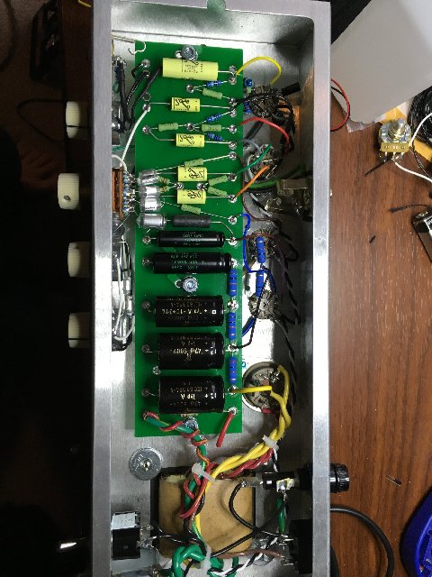

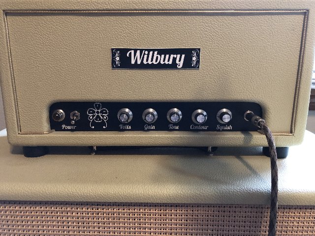

Anyway, here's my main amp that I'm really pleased with. It started life as a Winfield Cyclone (EF86 AC15 style), but after many problems, returns, new transformers and a replacement, I decided to just totally gut it and do my own thing. Not a single issue, including no hum for 2 years now.
Added a cap switch like a Matchless
Added Grid stop resistors
Biased it more sensibly and upped screen resistors so it doesn't eat EL84s
Added a 'squish' compression mod on the EF86
Added a voltage control
Princeton-style treble cut tone control
Sozo film caps
F&T filter caps
1W and 2W Carbon film resisors
And as a Tom Petty devotee, I called it the Wilbury and put the Wildflowers logo on it. Love how this thing sounds and how versatile it is.
Cooder, your work is the best I've seen on the entire friggin internet.
Too much kudos , Jason.... there's so much amazing stuff out there from all you guys! Thanks anyway, I'll take it as a high five in lockdown times.
If they sound half as good as they look then I might as well just go deaf now! That's some real amp porn cooder, hawt dayum!
Cheers Dude! I like to think they sound great and I know I might be a bit biased. Anyway, good fun doing DIY and making things.
